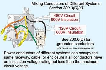

Power conductors of different systems can occupy the same raceway, cable, or enclosure if all conductors have an insulation voltage rating not less than the maximum circuit voltage (Fig. 1). You must separate control, signal, and communications wiring from power and lighting circuits to prevent the higher voltage conductors from accidentally energizing them. Exceptions to this requirement allow power conductors to terminate to listed signaling equipment if the power conductors maintain at least a 0.25-inch separation from the low-voltage and limited-energy conductors.
