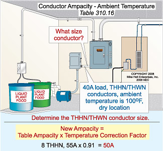

Let's work an example for practice. What's the minimum size THHN/THWN conductor you can use to supply a 40A noncontinuous load in a dry location, if the conductors pass through an ambient temperature of 100°F (Fig. 1)?
Corrected Ampacity = Table 310.16 Ampacity × Ambient Temperature Correction Factor
For a dry location, use the 90°C column for THHN.
Ambient Temperature Correction Factor for 100°F = 0.91 for THHN
Table 310.16 ampacity for 10 THHN is 40A at 90°C in a dry location
10 THHN = 40A × 0.91 = 36.40A. This is too small for the 40A load.
Table 310.16 ampacity for 8 THHN is 55A at 90°C in a dry location: Use the THHN 90°C column.
8 THHN = 55A × 0.91 = 50A
Therefore, an 8 AWG conductor is the answer to this question.
