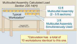

The multioutlet receptacle assembly, such as a plug strip, is common in commercial applications. For each 5 ft (or fraction thereof) of multioutlet receptacle assembly, use 180VA in your feeder/service calculations. This is assuming that it's unlikely for the appliances plugged into this assembly to operate simultaneously [220.14(H)].
If you expect several appliances to operate simultaneously from the same multioutlet receptacle assembly, consider each foot (or fraction of a foot) as 180VA for feeder/service calculations. A multioutlet receptacle assembly isn't generally considered a continuous load.
Try this sample problem to determine the feeder/service load. What's the calculated load for 10 workstations (Fig. 1), each of which has 10 ft of multioutlet receptacle assembly (not used simultaneously) and 3 ft of multioutlet receptacle assembly (used simultaneously)?
10 stations with 10 ft per station = 100 ft of multioutlet assembly (not simultaneously used)
10 stations with 3 ft per station = 30 ft of multioutlet assembly (simultaneously used)
100 ft ÷ 5 ft per section = 20 sections x 180VA = 3,600VA
30 ft ÷ 1 ft per section = 30 sections x 180VA = 5,400VA
Calculated load = 3,600VA + 5,400VA = 9,000VA
This next example shows how to size the branch circuits using 20A branch circuits.
First, find the VA allowed per circuit:
120V x 20A = 2,400VA for noncontinuous loads
Then, divide by 180VA to find how many 180VA sections a 20A circuit can serve:
2,400VA ÷ 180VA = 13
Each work bench requires 2 – 180VA sections for the 10 ft section, and 3 – 180VA sections for the 3 ft section, which is 5 – 180VA sections per workbench. At 13 sections per circuit, a 20A branch circuit can serve two tables.
