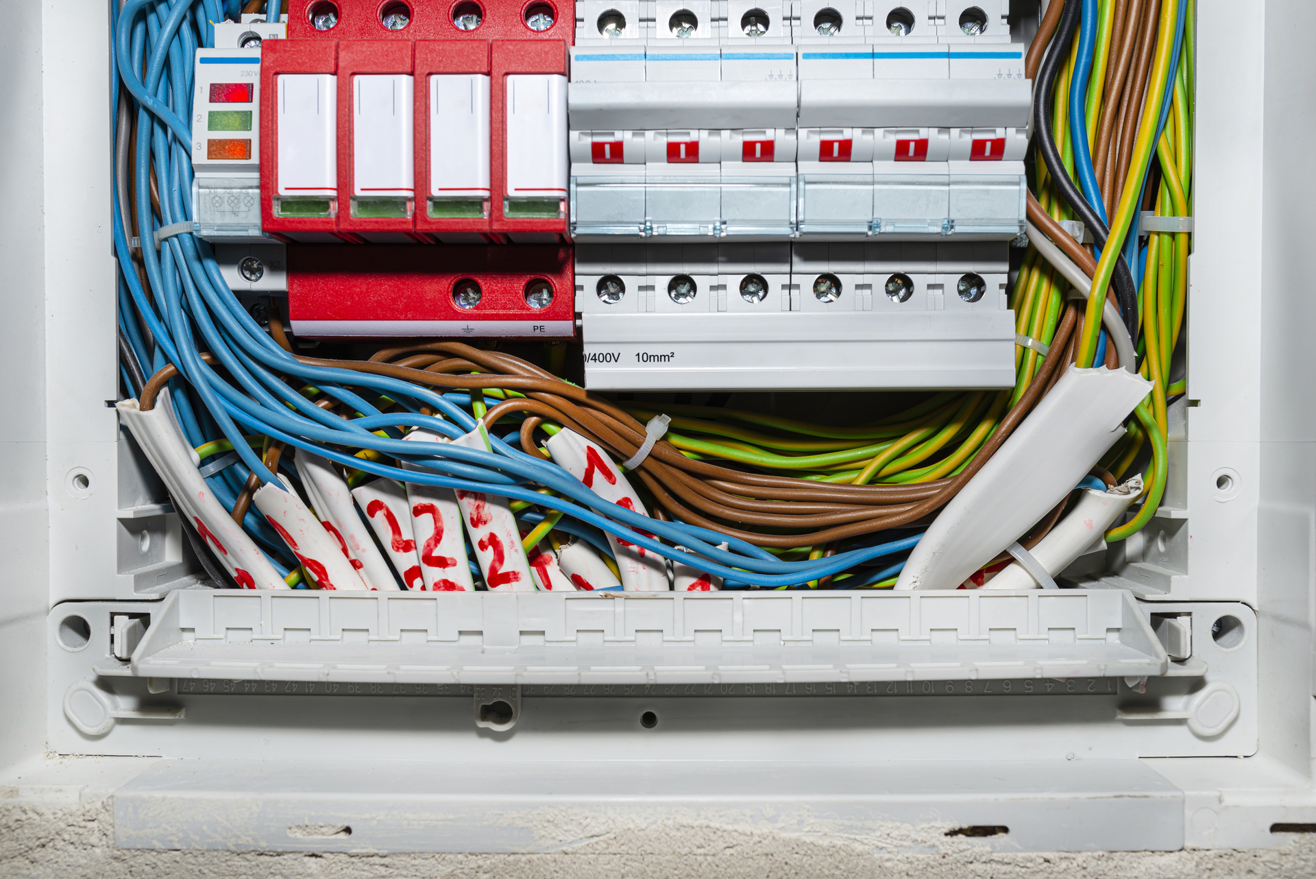

To make the distinction between surge protection devices (SPDs) and surge arrestors clear, the voltage level is stated. Part II of Art. 242 is for voltage protection at 1,000V or less (which means SPDs) and Part III is for voltage protection above 1,000V (which means surge arrestors).

SPDs, 1,000V or less
These are typically installed indoors but can be installed outside [Sec. 242.22]. You would use an SPD outdoors where the MCOV is 1,000V or less, rather than use a surge arrestor for that purpose. For example, you have an outbuilding that is supplied by a 480V feeder from another building or it’s a residential application (120/240V).
You can’t use SPDs [Sec. 242.9]:
  1. For circuits more than 1,000V.
  2. On systems that are ungrounded, impedance-grounded, or corner-delta-grounded unless listed specifically for such a system.
  3. Where the SPD rating is less than the MCOV at the point of application.
Every SPD (other than a receptacle SPD) is marked with a short-circuit rating. Don’t install it where the available fault current exceeds that rating [Sec. 242.10].
SPDs are Type1, Type 2, Type 3, or Type 4 [Sec. 242.12, 14, 16, and 18 respectively). The installation requirements differ, and each is designed for a different location in the power distribution system. You install:
  • Type 1 SPDs before the main OCPD.
  • Type 2 after the main OCPD.
  • Type 3 on the load side of the branch circuit OCPD.
Type 4 you don’t actually install; only an equipment manufacturer can install a Type 4. It’s a component-type SPD; for example, one that is integrated into the power supply of a piece of equipment.
