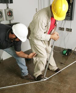

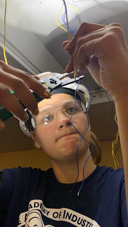

Non-metallic sheathed cable, mineral-clad cable, and Type UF cable are all wiring methods. In addition, we use specific materials to protect conductors (rigid metal conduit or RMC, electrical metallic conduit or EMT, and rigid PVC conduit), which are also wiring methods. Basically, just remember this: If you can bend it (Photo 1), pull it (Photo 2), or terminate it (Photo 3), it’s in Chapter 3.
