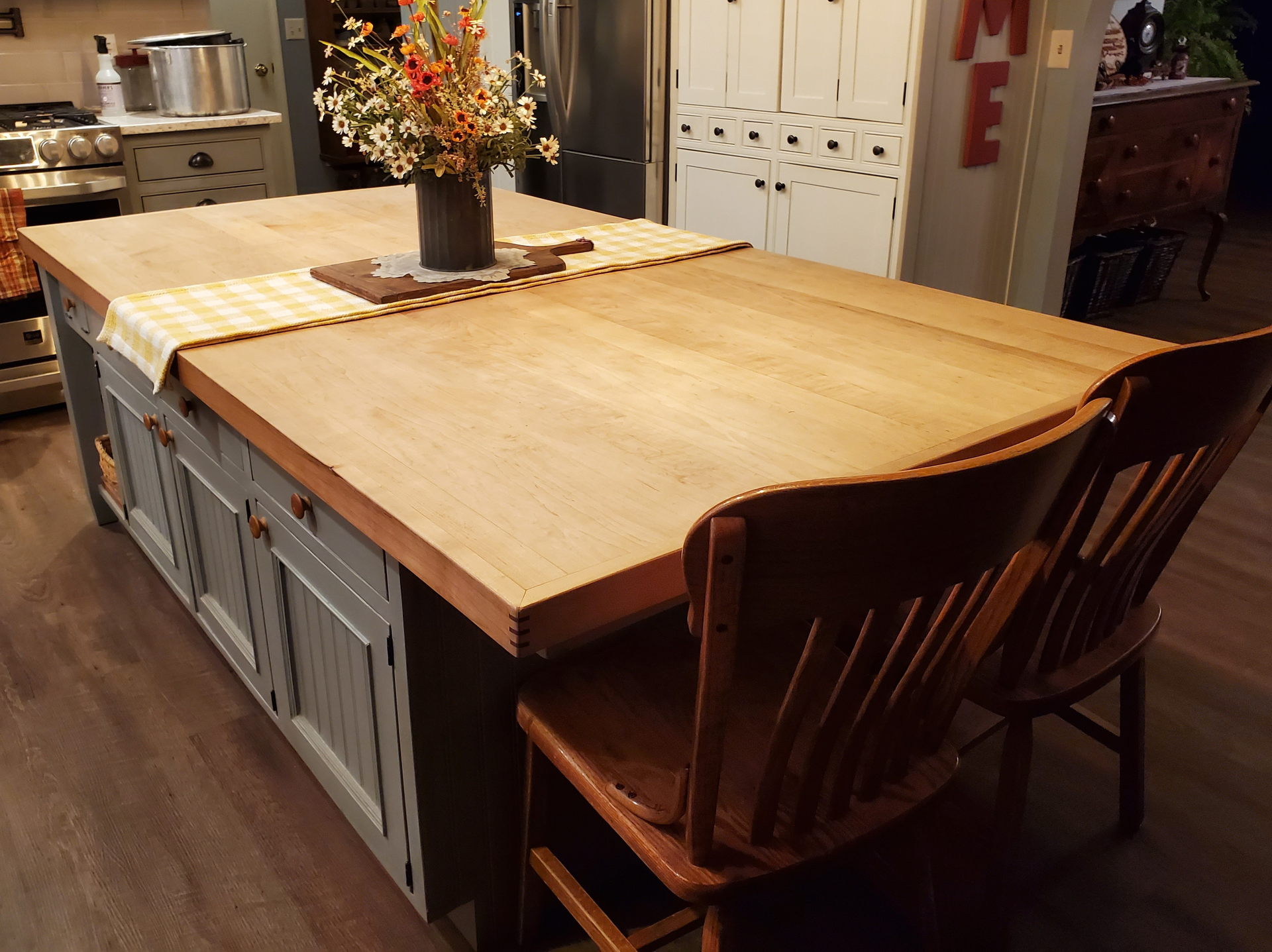

Photo 1. An example of a large kitchen island.

The countertop in Photo 6 of this island is 4 ft × 7 ft 4 in. for a total area of 29.3 ft2. According to Sec. 210.52(C)(2)(a), a receptacle is required for the first 9 ft2 and another receptacle for every additional 18 ft2 or fraction thereof of countertop or work surface. The resultant requirement for this island would be three receptacles.
Although the island in Photo 6 was built prior to adoption of the 2020 NEC, the clever cabinet maker allowed for all three receptacles. Arrow 1 in the photo points to a trap door that (when opened) reveals a GFI receptacle. There is a similar trap door/receptacle arrangement on the opposite side of the island.
Then, for the third receptacle, there may also be situations that require some commonsense application of the Code at the discretion of the AHJ. In this photo, Arrow 2 points to a receptacle that was installed under the countertop overhang but close to the edge where draping of the cord could be minimized. Although not in exact compliance with the letter of the Code [Sec. 210.52(C)(3)(3)], the reasoning noted in Sec. 210.8 could be employed: ...the distance shall be measured as the shortest path the cord of an appliance connected to the receptacle would follow....”
