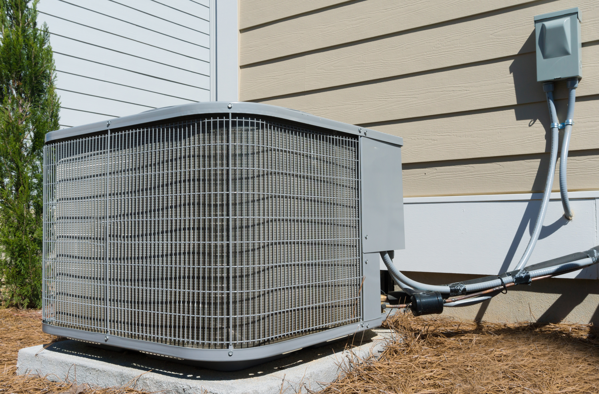

The National Fire Protection Association (NFPA) recently issued two Tentative Interim Amendments (TIAs) to the 2020 edition of NFPA 70, National Electrical Code. Open for comments until July 19, TIA Log No. 1589 (which was submitted by Dan Buuck, National Association Home Builders, and Clayton Traylor, Leading Builders of America) and TIA Log No 1593 (submitted by Dean Hunter, Minnesota Department of Labor & Industry) both seek to revise Section 210.8(F). Anyone can submit a comment here.
TIA Log 1589
1. Revise Section 210.8(F) to read as follows:
210.8 Ground-Fault Circuit-Interrupter Protection for Personnel. ...(F) Outdoor Outlets. All outdoor outlets for dwellings, other than those covered in 210.8(A)(3), Exception to (3), that are supplied by single-phase branch circuits rated 150V to ground or less, 50A or less, shall have ground-fault circuit-interrupter protection for personnel. This requirement shall become effective January 1, 2023, for heating/ventilating/air-conditioning (HVAC) equipment.
Substantiation: GFCI protection was expanded in the 2020 NEC without HVAC component and equipment safety standards being harmonized with GFCI amperage limits. Currently, the UL standard that HVAC equipment is listed to (UL 1995) has no requirements for leakage current if the unit is hard wired, as most residential air conditioners/heat pumps are. In the future, HVAC equipment will be listed to UL 60335-2-40, which sets a limit of 10 milliamps of leakage current. However, this new standard is not mandatory until 1/1/2024. UL 943 is the standard to which GFCI breakers are listed and are required to trip at 5 milliamps of current. Even if HVAC equipment is listed to the UL 60335-2-40 standard, there is no guarantee it will be compatible with UL listed GFCI breakers This lack of coordination is what is leading to the nuisance tripping that customers are dealing with.
Until both equipment and component standards are updated, designers, installers, AHJs, and consumers are forced to choose between an NEC 2020 compliant installation or an operational installation. In jurisdictions that have adopted 2020 NEC with 210.8(F) intact, there have been numerous instances of field tripping of the GFCI breaker on ductless mini splits, units containing power conversion equipment, and on many single-stage units.

TIA Log No. 1593
1. Revise 210.8(F) to read as follows:
210.8 Ground-Fault Circuit-Interrupter Protection for Personnel. ... (F) Outdoor Outlets. All outdoor outlets for dwellings, other than those covered in 210.8 (A)(3), Exception to (3), that are supplied by single-phase branch circuits rated 150V to ground or less, 50A or less, shall have ground-fault circuit-interrupter protection for personnel. This requirement shall become effective on January 1, 2023, for mini-split-type heating/ventilating/air-conditioning (HVAC) equipment and other HVAC units employing power conversion equipment as a means to control compressor speed.
Informational Note: Power conversion equipment is the term used to describe the components used in HVAC equipment that is commonly referred to as a variable speed drive. The use of power conversion equipment to control compressor speed differs from multistage compressor speed control.
Exception: Ground-fault circuit-interrupter protection shall not be required on lighting outlets other than those covered in 210.8(C).
Substantiation: This expansion of GFCI protection in the 2020 NEC, for the purpose of covering exterior outlets through 250V at dwelling units, is a necessary enhancement for electrical safety. Code Making Panel 2 supported the expansion of GFCI protection to cover these outdoor outlets based on the electrocution of a young boy who came into contact with the energized enclosure of an outdoor HVAC unit.
The purpose of this TIA is not to eliminate the GFCI protection for all HVAC outdoor equipment, but to extend the date of enforcement for the circuit supplying the HVAC units employing power conversion equipment.
Emergency Nature: The proposed TIA intends to correct a circumstance in which the revised NFPA Standard has resulted in an adverse impact on a product or method that was inadvertently overlooked in the total revision process or was without adequate technical (safety) justification of the action.
In the state of Minnesota, we began enforcing Section 210.8(F) on April 5, 2021, and we have already documented many cases of operational tripping occurrences which have been difficult for inspectors and electricians to resolve. The only solution at this time is for the AHJ to approve a temporary allowance for the installation of a circuit breaker without GFCI protection so that these HVAC units can operate.
The language in this TIA is in direct alignment with the once-proposed TIA 1529 that was supported by Code Making Panel 2 for Technical and Emergency Nature. The Correlating Committee also agreed that no correlating issues existed with this language; however, the TIA narrowly failed ballot with regards to the Emergency Nature. Recently, proposed TIA 1564, which included “all HVAC equipment” failed ballot, but had multiple voting member comments supporting the language in TIA 1529. Also, TIA 1564 language contains substantiation to support reasons for delaying the date to address the operational GFCI tripping.
As we enter into the peak cooling season in Minnesota and in other states where the 2020 NEC has been adopted, it is expected that this issue will continue to grow and be problematic for the enforcement and installation community. Delaying the implementation date allows for the affected stakeholders to reach a solution to the operational tripping occurrences and provides AHJs with the ability to permit installations of cooling equipment that is essential to the health and safety of residents in warm climates.
