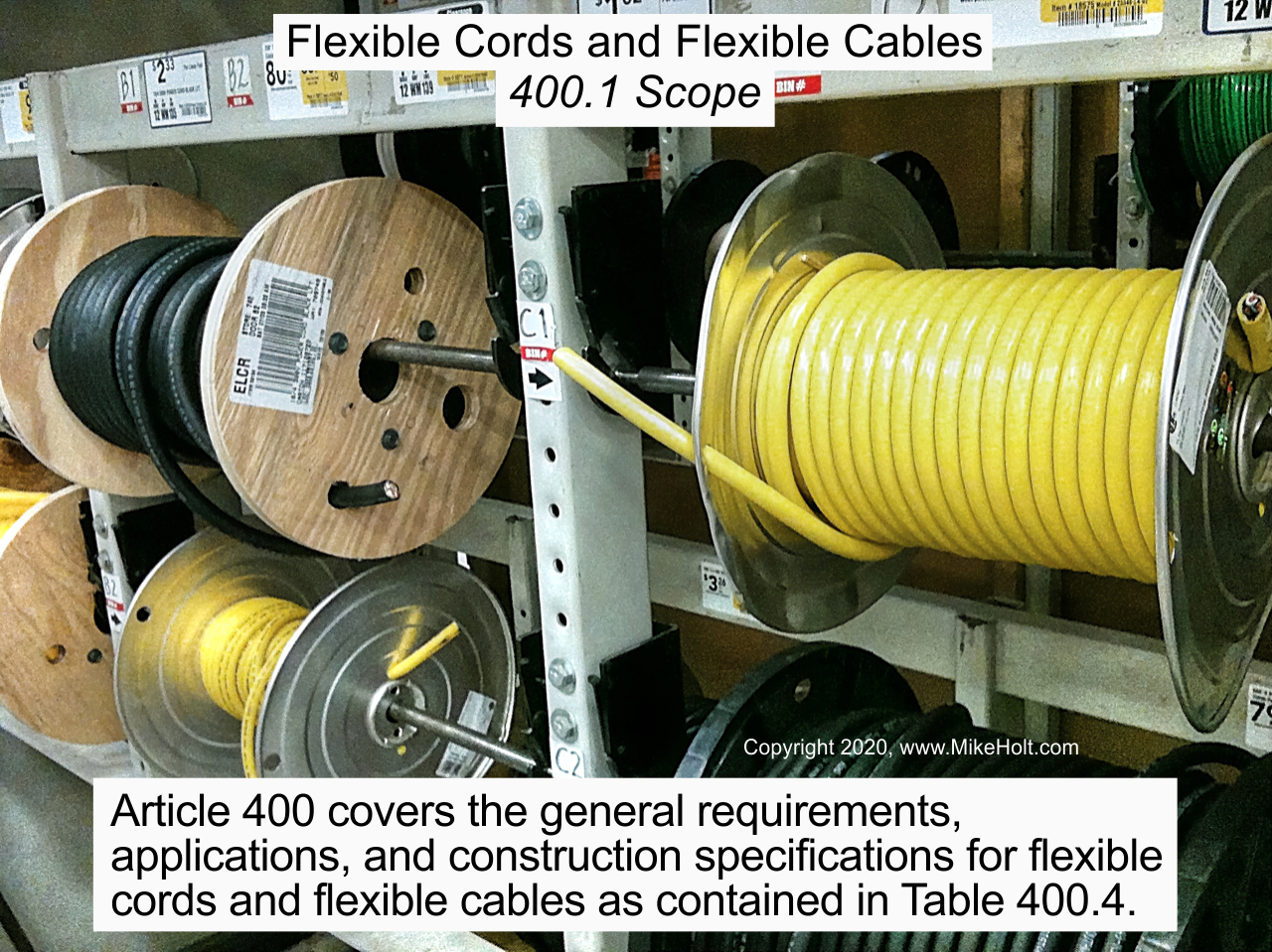

Article 400 covers the general requirements, applications, and construction specifications for flexible cords and flexible cables. You can get a sense of the sheer variety of them and their applications by reviewing Table 400.4 (Fig. 1).
