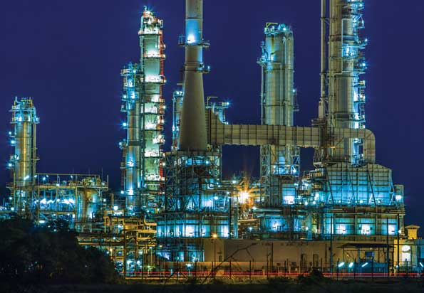

Petrochemical plants present an electrical designer with many classification challenges.
