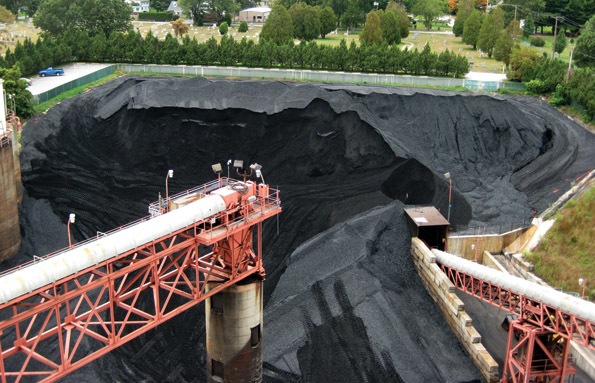

Before completing the design of this coal handling system, Black

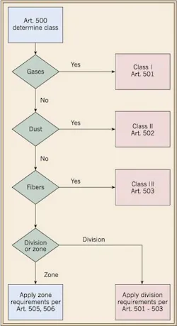

The NEC arranges flammability properties into Class I, II, and III, in Art. 501, 502, and 503, respectively. It defines and describes these in Art. 500 (OSHA also defines and describes these). Art. 500 is the basis for all hazardous location work and the related Articles that follow it (see Figure).
This flowchart helps you determine the appropriate Articles and Sections of the NEC to apply when designing and installing equipment in hazardous locations of a facility.
You don’t use Art. 500 by itself; you always pair it with at least one other in the series. All hazardous locations come under Art. 500. Then the requirements are modified according to Class (and then further modified according to additional breakdowns).
