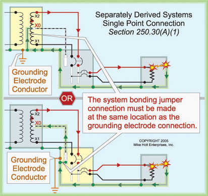

250.30(A) Grounded Systems. Separately derived systems must be system bonded and grounded in accordance with the following:
A neutral-to-case bond must not be on the load side of the system bonding jumper, except as permitted by 250.142(B).
(1) System Bonding Jumper. Bonding the metal parts of the separately derived system to the secondary grounded neutral terminal by the installation of a system bonding jumper ensures that dangerous voltage from a secondary ground fault can be quickly removed by opening the secondary circuit’s overcurrent protection device [250.2(A)(3)].
The system bonding jumper must be sized in accordance with Table 250.66, based on the area of the largest ungrounded secondary conductor [250.28(D)]. The system bonding jumper can be installed at the separately derived system, the first system disconnecting means, or any point in between the separately derived system and the first disconnecting means — but not at both locations.
In addition, the system bonding jumper must be installed at the same location where the grounding electrode conductor terminates to the grounded neutral terminal of the separately derived system, which can be at the separately derived system, the first system disconnecting means, or any point in between — but not at more than one location [250.30(A)(3)].
Exception 2: A system bonding jumper can be installed at both the separately derived system and the secondary system disconnecting means where doing so doesn’t establish a parallel path for neutral current.
For all practical purposes, this isn’t possible except in a wood frame building that doesn’t have any conductive metal.
(2) Equipment Bonding Jumper Size. Where an equipment bonding jumper is run to the secondary system disconnecting means, it must be sized in accordance with Table 250.66, based on the area of the largest ungrounded secondary conductor.
(3) Grounding Electrode Conductor, Single Separately Derived System. Each separately derived system must have the grounded neutral terminal grounded (earthed) to a suitable grounding electrode of a type identified in 250.30(A)(7). The secondary system grounding electrode conductor must be sized in accordance with 250.66, based on the total area of the largest ungrounded secondary conductor. To prevent objectionable current from flowing onto metal parts of electrical equipment, as well as metal piping and structural steel, the grounding electrode conductor must terminate at the same point on the separately derived system where the system bonding jumper is installed.
