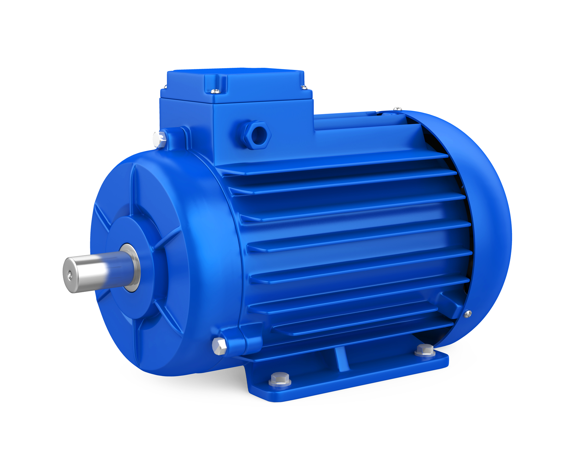

But there’s a problem. A single motor drives the main conveyor for this system. It often will not start for up to 30 minutes after the downtime reason is resolved, which puts the total acceptable downtime past the point where the line can meet demand. And some revenue is lost forever.
You’ve been tasked with solving this problem with this motor. What should you do?
Monitor temperature
The 30-minute delay indicates the overload protection for this motor is thermal rather than current-sensing. Start by monitoring the temperature where the thermal device monitors it. For example, install a thermocouple next to the sensor of the thermal relay (if it’s what’s being used). Use the thermocouple output as an input to a temperature-logging display device. Or if the system is under PLC control, then run it to a PLC module that can accept the input.
The point of monitoring and recording the temperature is so you can determine if the thermal device is correct for this application. If it is not correct, you may solve the problem by replacing or adjusting the device. If the motor has an integrated thermal device you cannot easily access, either have a motor shop replace it or replace the whole motor and use an external overload device (per 430, Part III).
While the instrument is collecting the data, examine where the motor lives. Drive motors are often subjected to being jammed into tight spaces, meaning restricted airflow. If the motor is taking too long between restart attempts, it also may be too hot while running. You can attack both problems by ducting in cooling air with a forced draft.
Another way to improve this situation is to replace this motor with an energy-efficient one that includes a higher insulation temperature rating. You could use a higher-rated thermal device to protect it and the required cooling time between starts would be substantially reduced.
Power quality problems could be causing the motor to run hot and, thus, take longer to cool. Check first for voltage imbalance. Since this line is critical, try to get the imbalance down to half a percent instead of the often recommended 2% target. Correcting for low power factor at the motor is another way to reduce the buildup of heat. If the motor has a variable-frequency drive (VFD) that is not power factor-corrected, replace it with one that is. If the motor does not include a VFD or soft starter, install one or the other so you eliminate those heat-generating, across-the-line starts.
