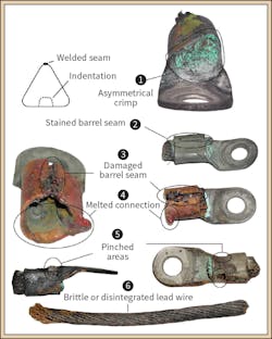

Crimp compression lugs. These lugs (Photo 2) attach to the conductors using specially designed mechanical or hydraulic crimping tools. Since the lugs come in various sizes and profiles (e.g., indented, hexagonal, or lobed), it’s critical to use the right crimping tool to avoid loose connections, damaged conductor strands, or misshapen crimps (Fig. 1).
Some crimp compression lugs are formed from a sheet of conductor material, so the barrels have a seam. To prevent split seams and loose joints, position the crimping tool so that it will indent the opposite side of the lug.
