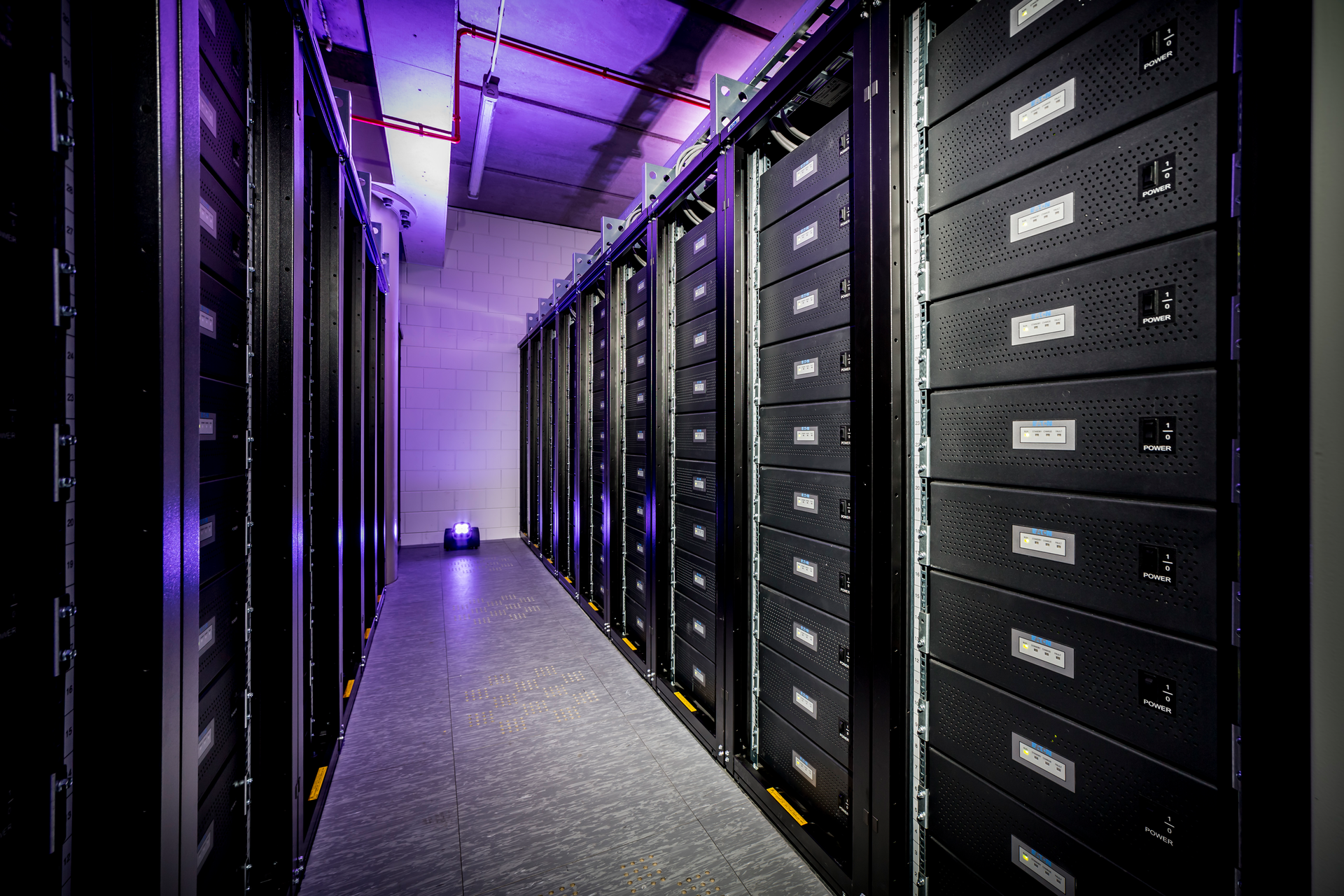

Photo courtesy of Eaton
While battery technology continues to evolve, codes and standards for safe application are also changing and new guidelines for testing are being introduced. Staying informed on new standards and testing guidelines is critical.
