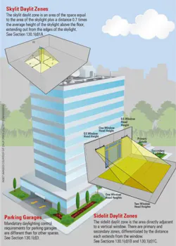

California’s Title 24 has detailed and explicit definitions of building areas where natural light comes into play in determining lighting restrictions and requirements (Image courtesy of Energy Code Ace and the California Statewide Codes
Requirements remain in force for the new 2016 edition that took effect Jan. 1, 2017. They were tweaked in the new edition to allow for some limited exceptions in applicability. But they generally retain the focus of making plug load controls a mandatory feature of new buildings and those undergoing extensive electrical rewiring or renovations.

Table. Lighting requirements in California’s Title 24 energy standard aim to factor and maximize natural lighting. These are some of the key sections of the code (Table courtesy of Energy Code Ace and the California Statewide Codes
