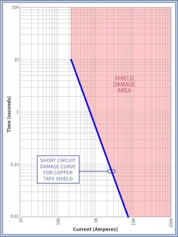

The reasons to avoid excessive ground-fault current on the shields are obvious from Fig. 3.
If a phase-A SLG fault were to occur at downstream equipment, the ground fault return and consequent tape shield damage on Phase-A cables would also affect Phase-B and Phase-C cables (see Fig. 4 for ground-fault current flow). Damaged shields and insulation mean that the entire affected run of cable is compromised and must be replaced.
Such damage can occur even with very short tripping times from an ANSI 50/51N (residual neutral overcurrent) or 50/51G (zero-sequence overcurrent) ground-fault protection device (see Fig. 5 for tape shield damage).
The solution is to ensure success by including an equipment grounding conductor (EGC), whether bare or insulated, as part of the bundle of MV cables being pulled. Although the NEC mandates the minimum size, a larger size ground conductor may be advisable. What we are trying to accomplish is to shunt as much current away from the shields as possible; the only way to accomplish that is by providing a parallel path with a reactance that competes with the shields themselves. The additional EGC must be within the bundle. The use of metallic conduits or ground conductors in a separate raceway (an afterthought) is ineffective and of little help with this problem. Strategically sizing the ground conductor also ensures that it will not reach a destructive temperature before the ground-fault protection device(s) trip the circuit. A coordination study helps determine what is needed.
It is nearly impossible to predict how multiple shield conductors in parallel will share the ground-fault return current due to the installation variables and the number and quality of grounding points but adding a low reactance and lower resistance parallel path by the use of an equipment grounding conductor will certainly help guard against thermal damage. Figure 6 and Fig. 7 depict the ground current flow and corresponding reduced copper tape shield damage curve when using an adequately sized EGC.
