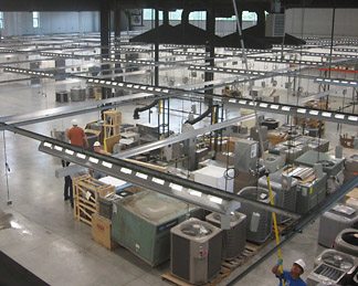

Another challenge included integrating flexibility into the HVAC, construction, and manufacturing labs, which KJWW overcame by installing extensive overhead electrical track busway systems that can power any piece of equipment in any location, regardless of voltage, phase, or load requirements.
“This adds to the building's sustainable goals, because it negates the need to add or remove conduit and wiring when equipment changes are made,” Leesman notes.
