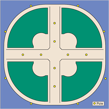

To meet the tournament level specifications required for the four fields at the Clinton Lake complex, Latimer, Sommers & Associates settled on a 16-pole design that supports 135 1,500W fixtures. The fields, which back into one another to create a circular design, each use two poles in the outfield and share four more with the fields adjacent to it (Figure).
