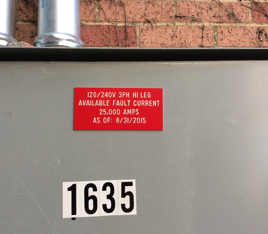

The Photo shows a label placed by an electric utility at the service meter. Although it doesn’t have it quite right, at least the utility spelled out that it is a 3-phase service. Note that the amount of useful information provided is atypical of most electric utilities and is really nice to see because it saves a lot of time for engineers and contractors not having to call around trying to find the department that can provide the service type and fault current information.
