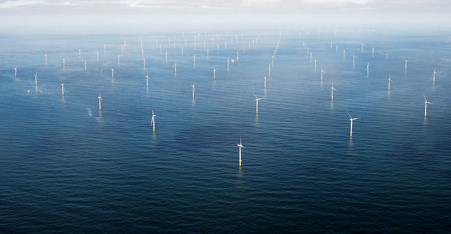

A wind power turbine began to turn last month above the waves in the North Sea 120 km (about 75 miles) off the U.K.’s Yorkshire Coast, the first of 174 Siemens Gamesa 7MW turbines that will make up the world’s largest offshore wind generation facility, Hornsea 1.
Under development by Danish power company Ørsted A/S and Global Infrastructure Partners, Hornsea 1 is expected to be completed in the first quarter of 2020 and will produce 1,200MW of power, nearly double the size of the current largest offshore wind farm, Walney Extension in the Irish Sea, and capable of powering well over one million U.K. homes with renewable electricity. According to the plan, Hornsea 1 will be surpassed by the second phase, Hornsea 2, which will produce 1,386MW beginning in 2022, and Hornsea 3, with an estimated maximum capacity of 2,400MW, slated for construction in 2022 to 2025.
“Hornsea 1 is the first of a new generation of offshore power plants that now rival the capacity of traditional fossil fuel power stations,” Matthew Wright, U.K. managing director at Ørsted, said in a press release. “The ability to generate clean electricity offshore at this scale is a globally significant milestone.”

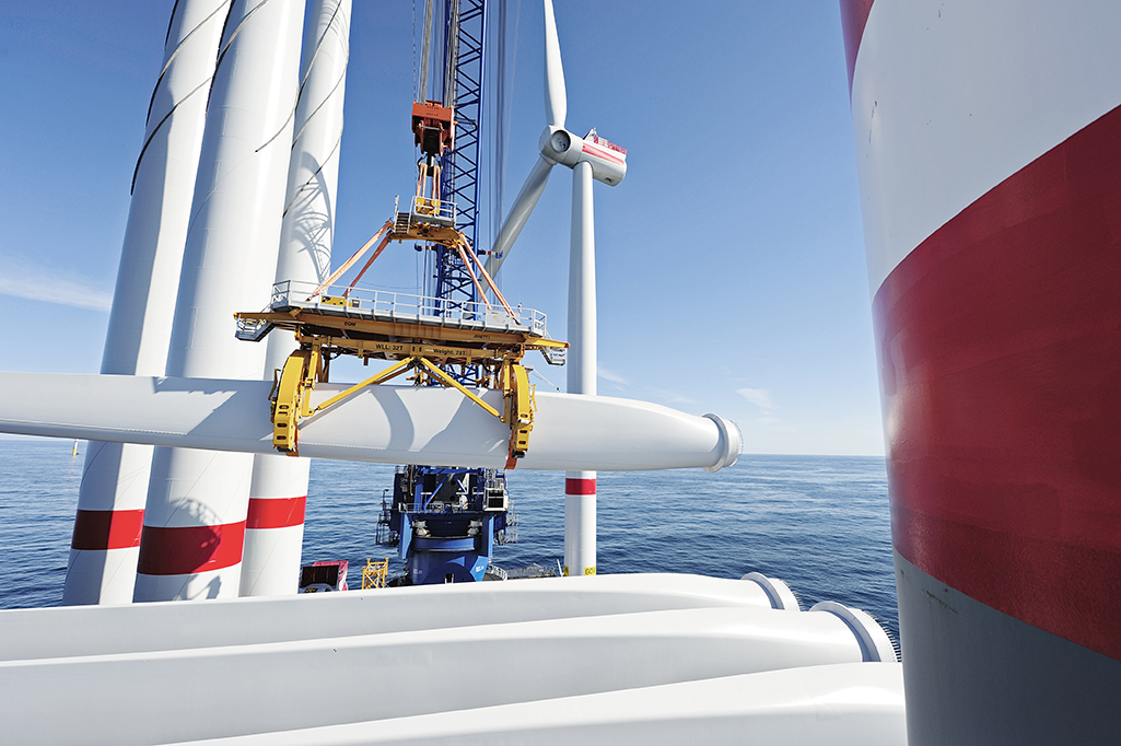

To date, 172 out of 174 monopile foundations have been installed at Hornsea 1, and turbine installation is expected to continue until late summer 2019. The electricity generated by the turbines will pass via undersea cables through one of three massive offshore substations, and the world’s first offshore reactive compensation station, all fully installed, before reaching shore at Horseshoe Point, Lincolnshire. The electricity is then transported via underground cables to the onshore substation in North Killingholme, where it connects to the U.K. National Grid, in order to reach well over one million homes in the United Kingdom.
