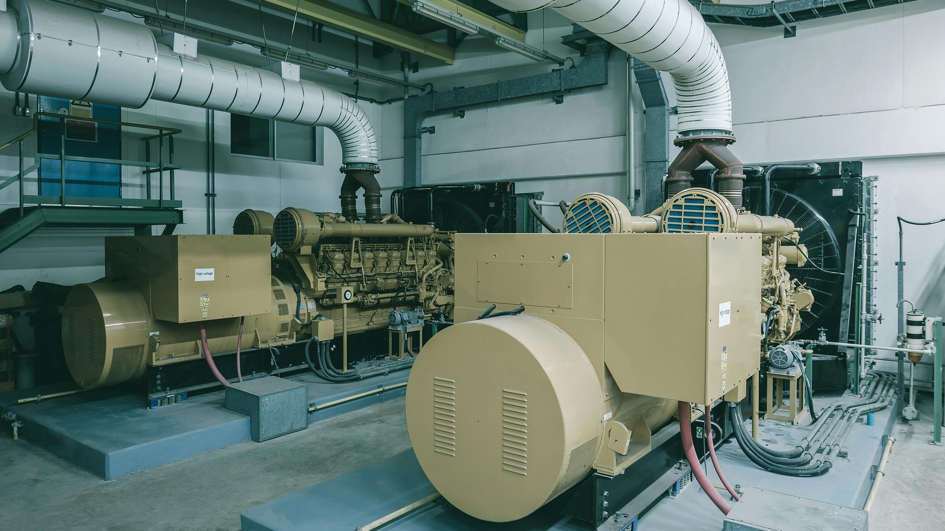

The automatic transfer switch (ATS) is part of a last resort system that comes into play when a facility succumbs to a voltage disturbance long enough to trigger the standby power equipment. The objective of this system is to transfer load from the electric utility system to a backup generator. Some facilities only back up selected equipment, such as critical loads that require a shutdown procedure, while others only connect emergency equipment that needs to remain on for the duration of the interruption. Other facilities use the backup generator to sustain most, if not all, of the facility until the electric utility system comes back online. Examples of these types of facilities include hospitals or hotels where patients and customers can have an adverse experience when power is not available. However a facility configures its backup topology, the ATS can create a large transient voltage during the switching process when inductive currents are disrupted. Any electronic load that is not connected behind a surge protection device will be directly subjected to this transient voltage. This can ultimately damage or reduce the life of electronic devices.
