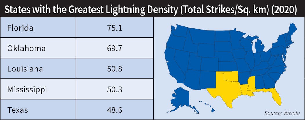

As climate change raises temperatures and produces more extreme storms, regions previously unaccustomed to lightning activity are now experiencing a greater number of strikes. The potential for damage is particularly concerning for critical facilities (like hospitals) in certain regions where most existing buildings do not have a lightning protection system (LPS). Left unprepared, a power surge could pose serious risks to patient care.
Warmer weather, greater risks
When or where lightning will strike is unpredictable. Nevertheless, climate researchers have drawn connections between surface temperatures, precipitation rates, and lightning flashes suggesting more lightning can be expected in the years ahead.
As temperatures warm, heavy precipitation events are likely to become more common, changing electrical balance in the air and causing lightning to strike. A study published in the journal Science concluded that every 1ºC rise in global temperatures will result in a projected 12% increase in lightning strikes.
The growing threat to buildings and other structures may already be real. Compared to the prior decade, from 2011 to 2020 the United States experienced a 40% increase in property damage events caused by lightning strikes, according to U.S. National Oceanic and Atmospheric Administration data. Lightning events often go unreported, especially from years back. Still, many building owners hospitals included are noticing an increase.

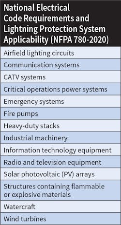

NFPA 70, National Electrical Code (NEC), and NFPA 780, Standard for the Installation of Lightning Protection, do not require lightning protection at all types of facilities or for all building structures. However, the number of systems that need to be protected has increased in recent iterations.
Protection designs must adhere to Underwriter Laboratories’ UL 96A, the definitive standard for lightning protection system installation requirements. UL 96A addresses air terminals, cable conductors, fittings, connections, and fasteners.
In addition, hospitals are encouraged by NFPA 780, NFPA 70, and the Facilities Guidelines Institute (FGI) to develop risk assessments and mitigation plans for weather events such as lightning strikes. Considerations when undertaking a safety risk assessment include the potential of lightning damage on:
