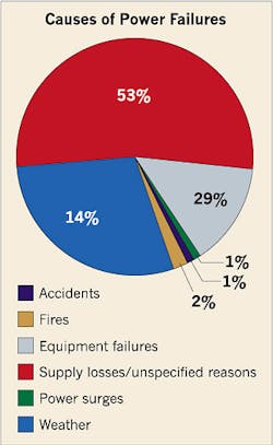

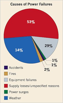

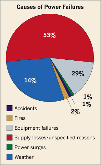

Fig. 1. Major causes of power failures in U.S. refineries from 2009 to 2013.

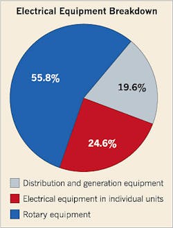

Fig. 2. The majority of power issues at U.S. refineries between 2009 and 2013 were due to rotary equipment trips, which include compressor motors and air blowers tripping.
Knowing the causes of power disruptions can help a refinery devise a plan to mitigate them. Figure 1 illustrates the major causes of power failures in U.S. refineries from 2009 to 2013. As the graphic shows, the majority of power failures are a result of the source power from the electric utility being lost or the feed being lost due to an unknown cause. The second biggest cause of power failures is electrical equipment interruptions. These include transformer failures, switchgear and circuit breaker breakdowns, compressor motors tripping, and more.
In Fig. 2, the distribution of electrical equipment breakdowns from 2009 to 2013 is shown. The majority of power issues are due to rotary equipment trips, which include compressor motors and air blowers tripping. The second leading cause is the refinery processing unit experiencing electrical problems. This is typically listed as “a hydrocracking unit had electrical issues.” The third cause is the failure of distribution and generation equipment, such as a transformer, switchgear, and circuit breaker.
