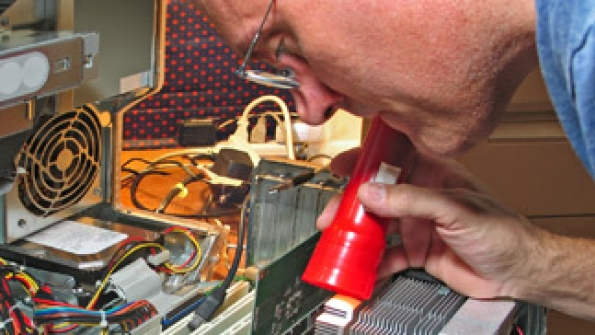

Damaged computer equipment could be caused by poor quality power supplies.
