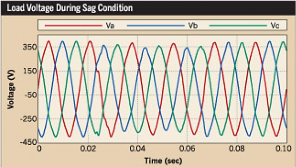

Response of motor loads to unbalanced voltage sags
Voltage sags caused by faults on the supply system are detrimental to the safety and normal operation of industrial processes. These short voltage variations can cause sensitive loads and controllers to trip offline, affecting the entire production process. Voltage sags can even affect conventional induction motors.
Figure 1A on page 30 shows the response of a motor load during a voltage sag condition caused by a single line-to-ground fault on the supply system. In Fig. 1B on page 30, note the severe unbalance in the current caused by the unbalanced voltages during the sag condition. This can cause negative sequence relays to operate. In some cases, the high currents following the sag can trip motors on overcurrent.
