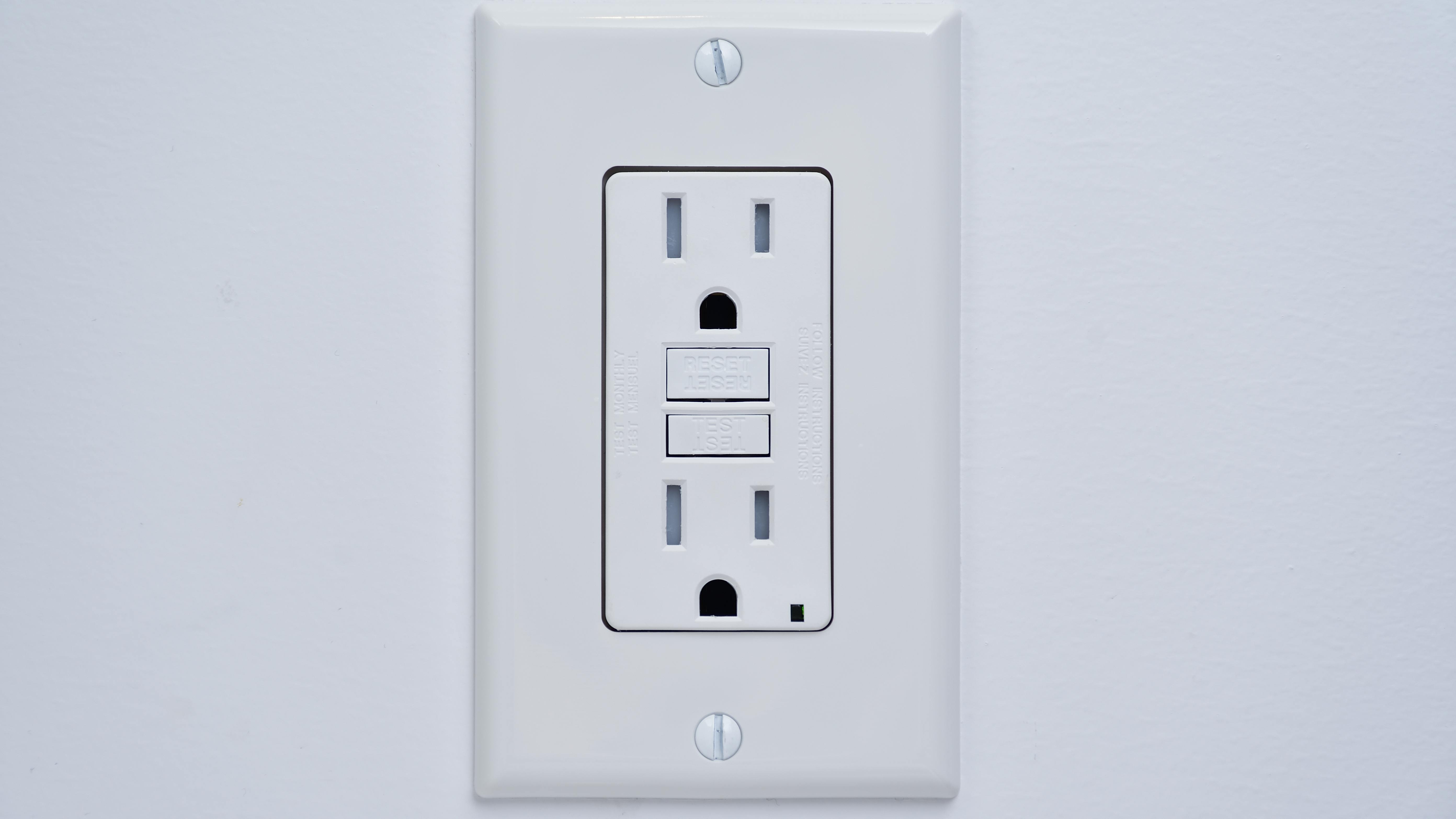

Photo 284201775 © Dominic Trudel | Dreamstime.com
tamper resistant gfci receptacle outlet

Q1: In other than dwelling units, all 125V through 250V receptacles supplied by single-phase branch circuits rated 150V or less to ground, 50A or less, and all receptacles supplied by three-phase branch circuits rated 150V or less to ground, 100A or less, installed in _____, shall be provided with GFCI protection.
a) laundry areas
b) finished basements
c) attics
d) guest rooms and suites

Q1: a) laundry areas.
Section 210.8(B)(14) lists "laundry areas" as a location that shall be provided with GFCI protection.
