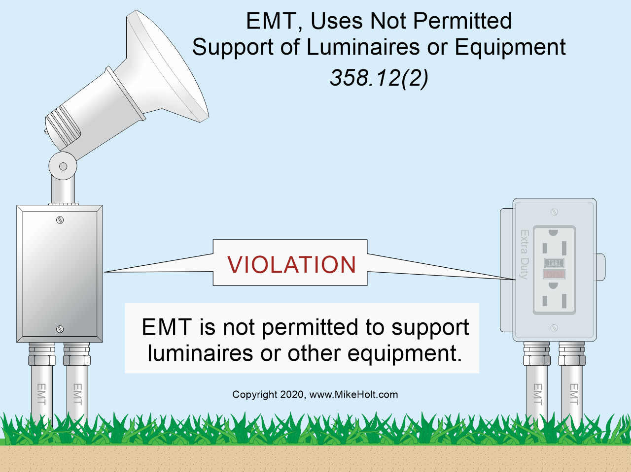

Fig. 1. Examples of EMT uses not permitted by the NEC.

Q: Under what conditions can EMT not be used and installed?
A: According to Sec. 358.12, EMT is not permitted to be used under the following conditions:
(1) Where subject to severe physical damage. 
(2) For the support of luminaires or other equipment (Fig. 1).
