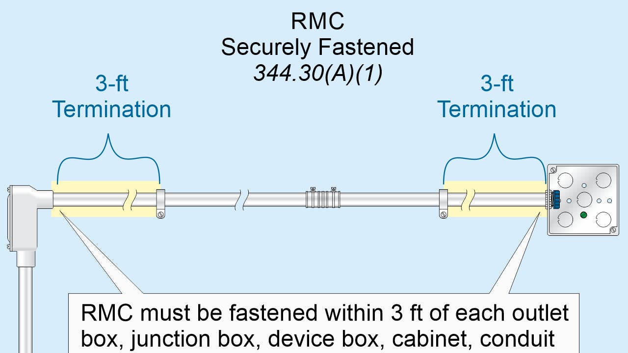

Q. What are the requirements for securing and supporting RMC?
See answer below.
A. The requirements for securing and supporting RMC are in Sec. 344.30.
RMC must be securely fastened in place and supported in accordance with (A) and (B).
(A) Securely Fastened. RMC must be secured in accordance with any of the following:
(1) Fastened within 3 ft of each outlet box, junction box, device box, cabinet, conduit body, or other conduit termination (Figure).
Author’s Comment: Fastening is required within 3 ft of terminations, not within 3 ft of each coupling.
(2) When structural members do not permit the raceway to be secured within 3 ft of a box or termination fitting, the raceway must be secured within 5 ft of the termination.
