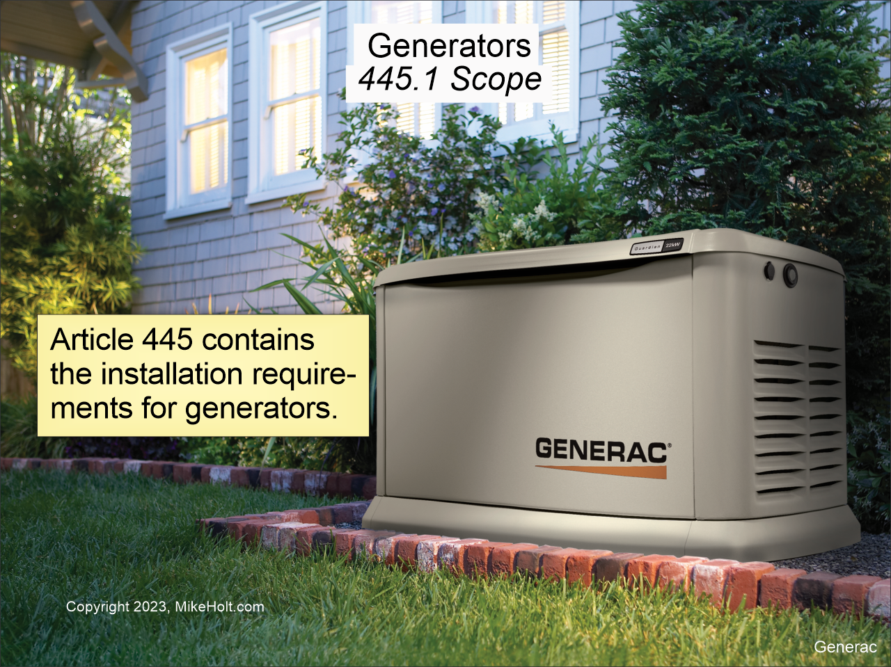

Fig. 1 The rules of Art. 445 include where generators can be installed, nameplate markings, conductor ampacity, and disconnect requirements.

Article 445 contains the electrical installation and other requirements for generators. These rules include such things as where generators can be installed, nameplate markings, conductor ampacity, and disconnect requirements (Fig. 1).
