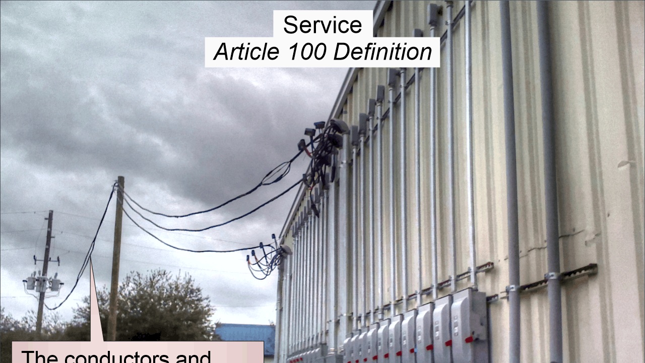

Article 230 covers the installation requirements for service conductors and service equipment.
A service consists of the conductors and equipment connecting the serving electric utility to the premises wiring system [Art. 100] (Fig 1).
