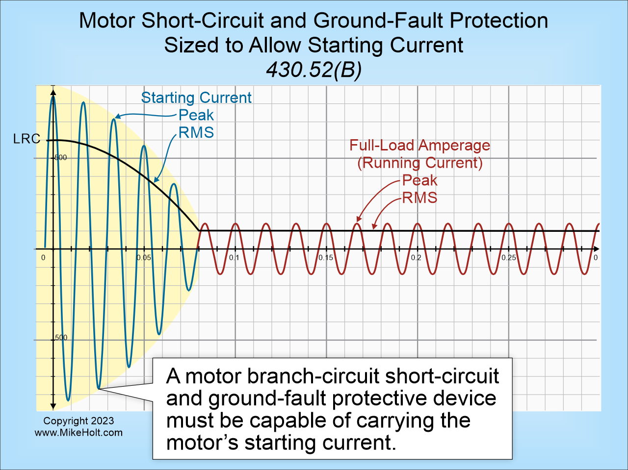

Fig. 1. A motor branch-circuit OCPD must be able to carry the motor’s starting current.

The motor branch-circuit OCPD must comply with Sec. 430.52(B), (C), and (if torque motors) (D) [Sec. 430.52(A)]. Section 430.52(B) is straightforward: A motor branch-circuit OCPD must be able to carry the motor’s starting current (Fig. 1).
