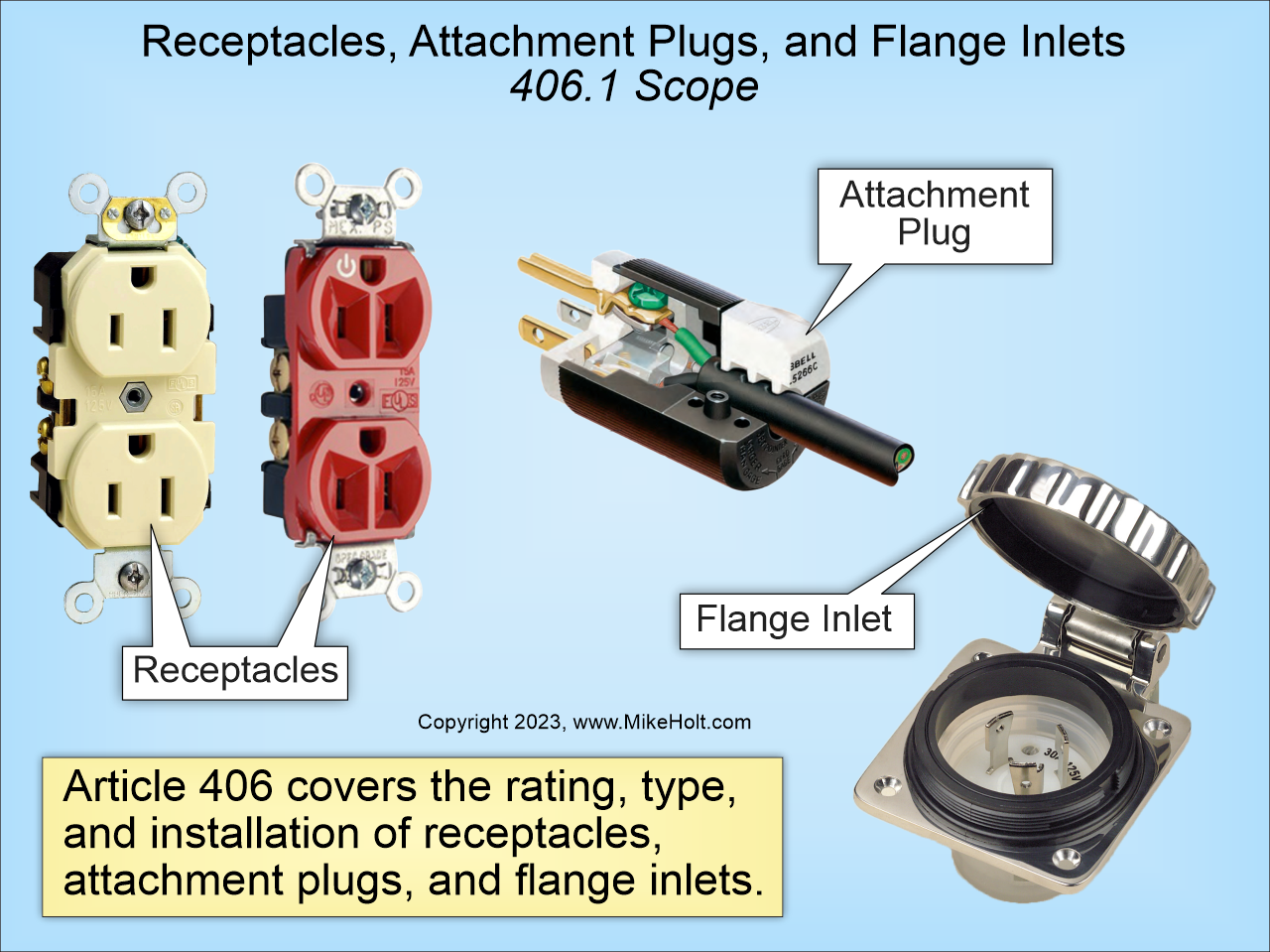

Fig. 1. The rating, type, and installation of receptacles, attachment plugs, and flange inlets can be found in Art. 406 of the NEC.
NEC Requirements for Receptacles
June 14, 2023
It’s easy to commit Code violations with receptacle applications if you don’t have a solid understanding of the NEC requirements.
Article 406 covers the rating, type, and installation of receptacles and attachment plugs. It also covers flanged surface inlets [Sec. 406.1], as shown in Fig. 1.
