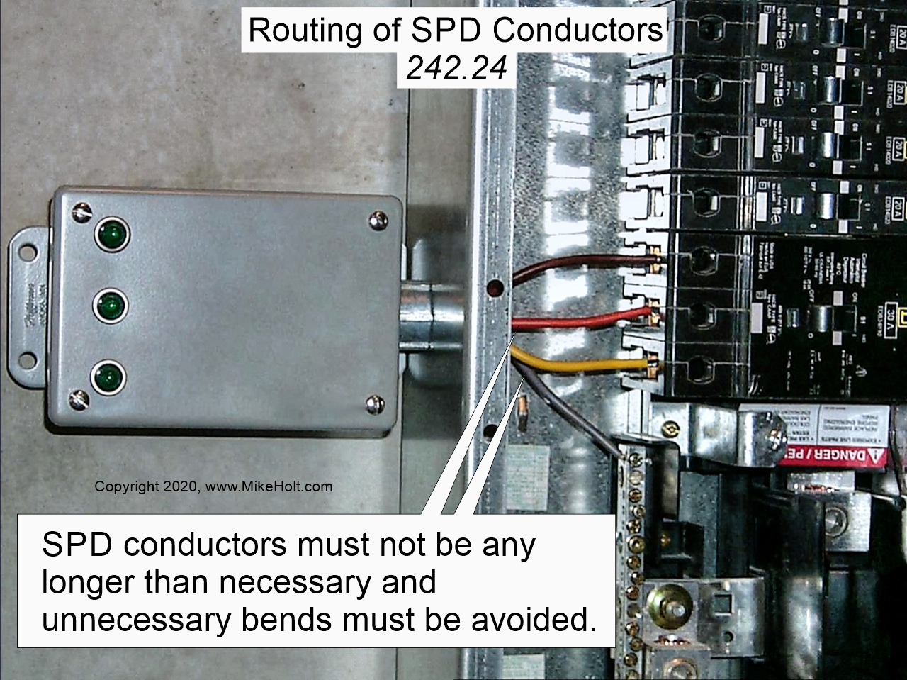

Fig. 1. Shorter conductors and minimal bends improve SPD performance by helping to reduce conductor impedance during high-frequency transient events.

Line and grounding conductors must be at least 14 AWG (12 AWG if aluminum) [Sec. 242.28]. Connect only one conductor to a terminal, unless the terminal is identified for multiple conductors [Sec. 110.14(A)]. Don’t make the leads any longer than necessary, and avoid bends that are sharp or unnecessary [Sec. 242.24] (Fig. 1). Shorter conductors and minimal bends improve SPD performance by helping to reduce conductor impedance during high-frequency transient events.
