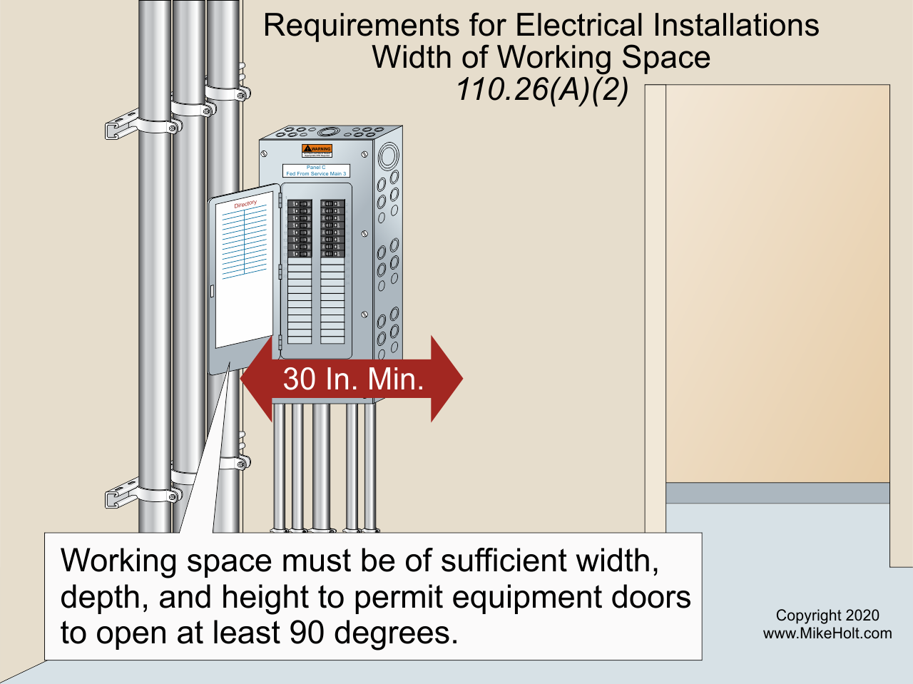

Fig. 1. The width of the working space can be measured from left to right, from right to left, or simply centered on the equipment.

The width of the working space must be at least 30 in., but in no case less than the width of the equipment [Sec. 110.26(A)(2)]. The width of the working space can be measured from left to right, from right to left, or simply centered on the equipment. It can overlap the working space for other electrical equipment.
The working space must be of sufficient width, depth, and height to permit equipment doors to open at least 90 degrees (Fig. 1).
