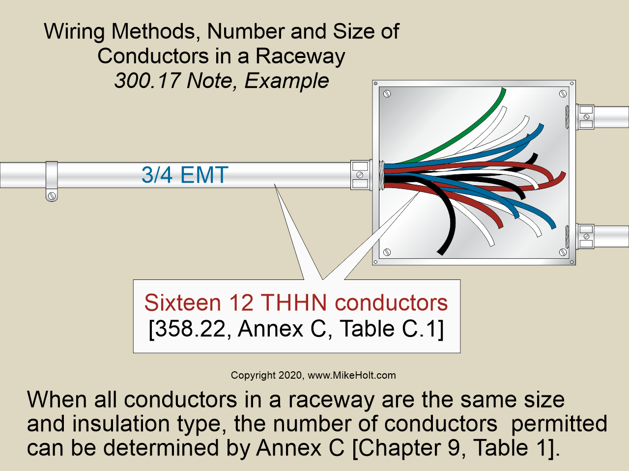

 Number and size of conductors in a raceway
Raceways must be large enough to permit the installation and removal of conductors without damaging the conductor insulation [Sec. 300.17]. When all conductors within a raceway are the same size and of the same insulation type, you can use Annex C (Table 1) to determine the number of conductors permitted for a specific raceway size (see Fig. 1 below).
If you install different size conductors in a raceway, conductor fill is limited to the percentages in Table 1 and Note (6) of Chapter 9. Those percentages are based on conditions where the length of the conductor and the number of raceway bends are within reasonable limits [Chapter 9, Table 1, Table Note 1].
