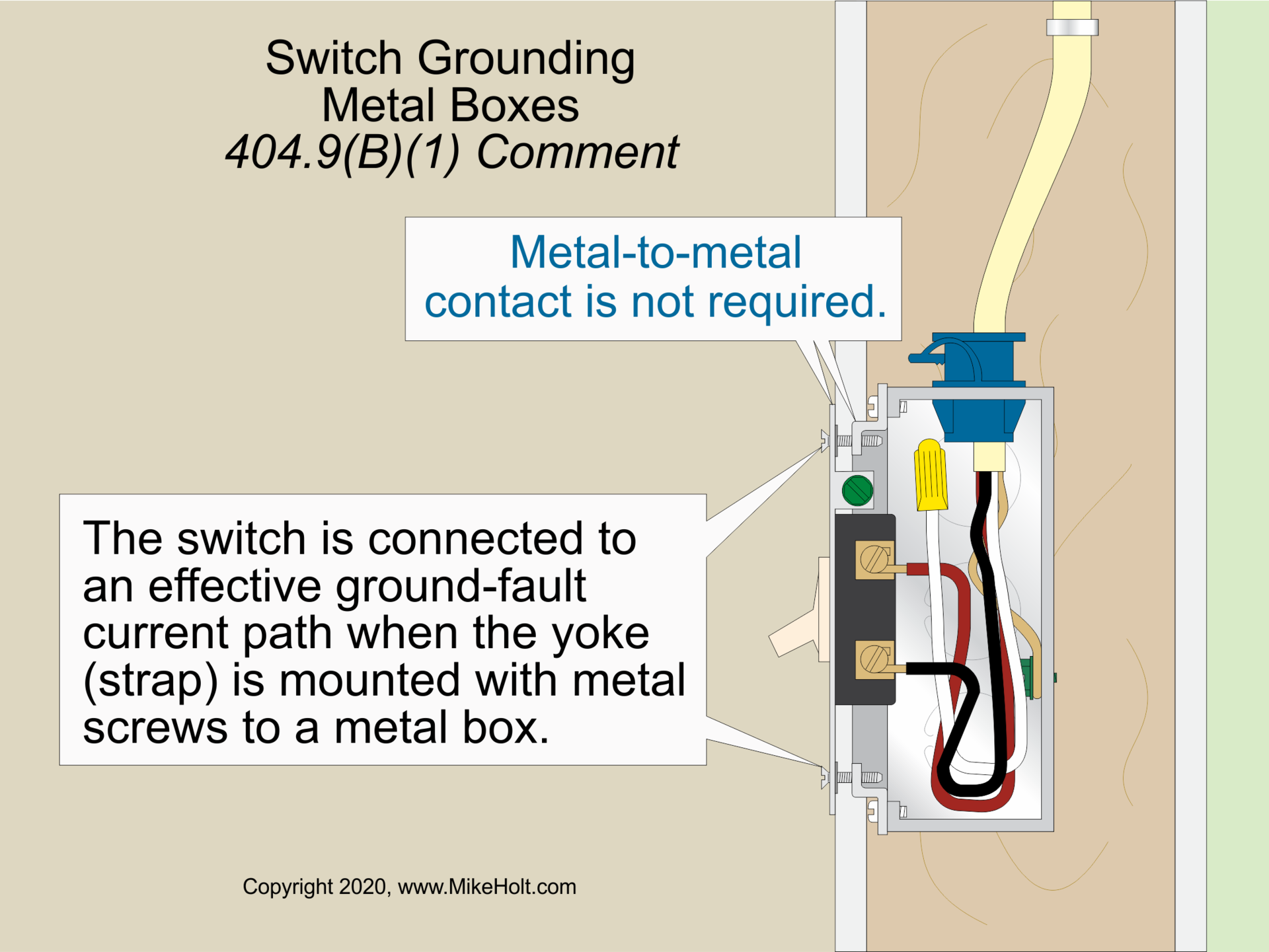

Fig. 1. Direct metal‑to‑metal contact between the device yoke of a switch and the box is not required.

The metal mounting yokes for switches, dimmers, and control switches must connect to an equipment grounding conductor. Metal faceplates must be bonded to the equipment grounding conductor (EGC) [Sec. 404.9(B)].
Snap switches, dimmers, control switches, and metal faceplates are considered connected to an EGC using either of the following methods:
(1) Metal boxes. The switch is mounted with metal screws to a metal box or a metal cover that is connected to an EGC per Sec. 250.148.
Direct metal-to-metal contact between the device yoke of a switch and the box is not required. The switch is connected to the effective ground-fault current path when the yoke is mounted with metal screws to a metal box (Fig. 1).
(2) Nonmetallic boxes. The grounding terminal of the switch yoke must connect to the circuit EGC.
