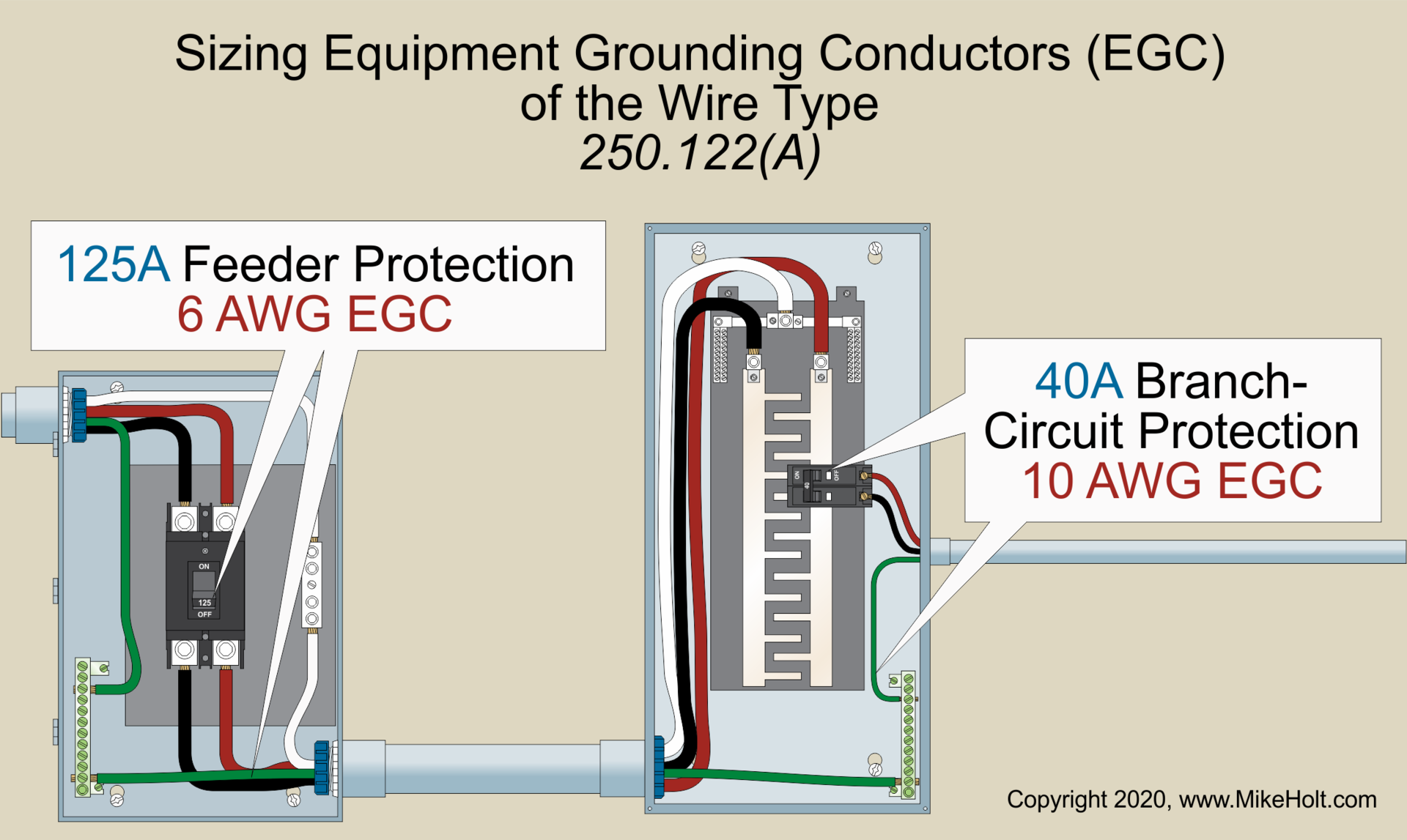

Fig. 1. Equipment grounding conductors must be sized not smaller than shown in Table 250.122; however, they are not required to be larger than the phase conductors.

Sizing EGCs of the wire type
If your EGC is the raceway or cable tray containing the conductors (rather than a wire-type EGC), it will be larger than the phase conductors — and you don’t need to bother with the table. So, when we are talking about sizing EGCs, we mean wire-type EGCs. If you use both raceway and wire-type EGC enclosed within, the size requirements still apply to the wire-type EGC.
EGCs must be sized not smaller than shown in Table 250.122; however, the EGC is not required to be larger than the phase conductors [Sec. 250.122(A)] (Fig. 1 below). Phase conductors are sometimes increased in size to accommodate conductor voltage drop, shortcircuit rating, or future capacity. If phase conductors are increased in size for any reason other than as required in Sec. 310.15(B) or (C), wire-type EGCs, if installed, must be increased in size proportionately to the increase in the circular mil area of the phase conductors [Sec. 250.122(A)]. Exception: EGCs can be sized by a qualified person to provide an effective ground-fault current path per Sec. 250.4(A)(5) or (B)(4).

You can use a single EGC sized per Table 250.122 when multiple circuits are installed in the same raceway, cable, trench, or cable tray [Sec. 250.122(C)] (Fig. 2 below).
