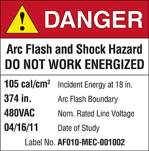

Table 1 (click here to see Table 1) presents the results of arc flash calculations per IEEE Std. 1584 at main switchboard SWBD0. Note that the results depend on the upstream trip device that clears the arc fault. Referring to Table 1, if primary fused switch FUPS serves as the upstream trip device for an arc fault at SWBD0, the incident energy level is 104.8 cal/cm2. This extreme incident energy level exceeds the upper limit of the highest Hazard/Risk Category 4 (i.e., 40 cal/cm2), and work on the switchboard cannot proceed until it has been put in an electrically safe work condition per Article 120 of NFPA 70E. However, if the main secondary breaker (MB0) serves as the upstream trip device, then the incident energy level is much lower (5.3 cal/cm2), which corresponds to a Hazard/Risk Category of 2*.
Based on Table 1, one may mistakenly believe that the extreme incident energy level applies only to the MB0 compartment of main switchboard SWBD0. However, an explosion due to an arc fault in a feeder breaker compartment could spread to all compartments of the switchboard (because the switchboard of this example is not arc resistant in construction) and render MB0 incapable of clearing the fault. Thus, the extreme incident energy level applies to all compartments of the switchboard, as shown in Table 2 (click here to see Table 2). Figure 2 provides a sample of an NFPA 70E-compliant arc flash label for the extreme incident energy level noted previously.
