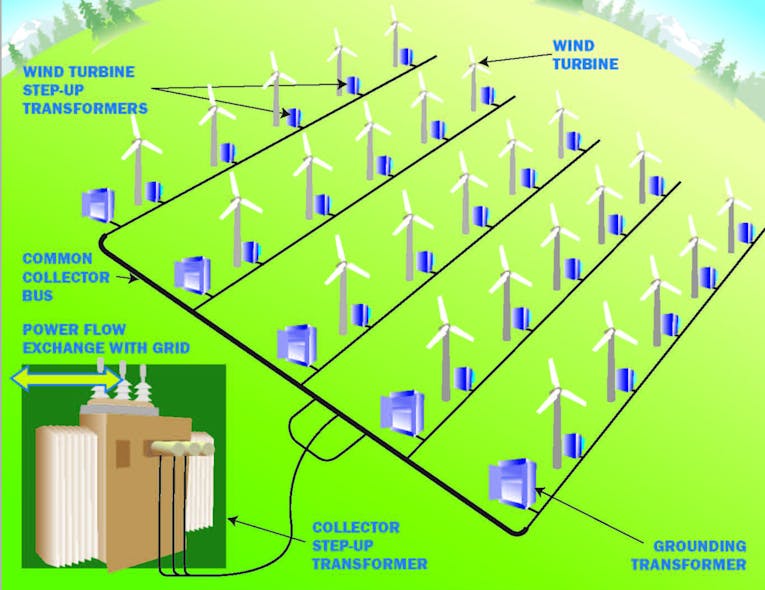

Grounding transformers are essential for large multi-turbine wind farms, where the substation transformer frequently provides the sole ground source for the distribution system. A grounding transformer placed on the turbine string provides a ground path in the event the string becomes isolated from the system ground.
When a ground fault on a collector cable causes the substation circuit breaker for that cable to open, the wind turbine string becomes isolated from the ground source. The turbines do not always detect this fault or the fact that the string is isolated and ungrounded. As a result, the generators continue to energize the collector cable, and the voltages between the un-faulted cables and the ground rise far above the normal voltage magnitude. The resulting costs can be staggering.
According to one source at Iberdrola, a global leader in wind energy development, the loss of revenue alone for a string of 10 turbines can exceed $10,000 per day. Considering removal and replacement, costs of equipment could approach an additional $40,000 per transformer. A typical wind farm configuration is actually somewhat analogous to a carriage wheel with a ring, hub, and spokes. The wheel's outer ring is like the fence around the wind farm, and the hub in the center is where the collector is located, which connects to the grid. The spokes are radial lines where each wind turbine sits. Typically, each radial string of turbines will connect to a grounding transformer, as shown in Fig. 1.
