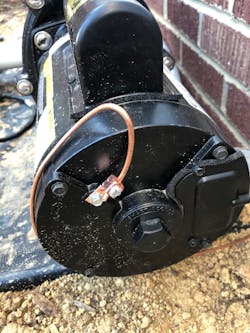

List item (6) addresses bonding metal parts of electrical equipment. This includes equipment such as electrically powered pool covers, water circulation, treatment, heating, cooling, or dehumidification, and all electrical equipment installed within 5 ft horizontally from the inside wall of a pool. There is an exception for listed equipment that incorporates an approved system of double insulation.

Bonding of metal parts of electrical equipment, per list item (6).Photo courtesy of Chris Faucette
