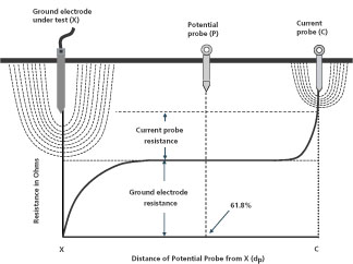

Along with the development of new instrumentation, the test procedure itself was also standardized. By “walking” the potential probe toward the current probe and graphing the measurements, the end-user could develop a profile that reliably indicated the ground electrode's resistance. This test procedure is otherwise known as the “Fall of Potential” method and is described by ANSI/IEEE “Guide for Measuring Earth Resistivity, Ground Impedance, and Earth Surface Potentials of an Earth System” (ANSI/IEEE Standard 81).
Various other popular test methods, such as Slope, 62% Rule, and Intersecting Curves, were all derived from the Fall of Potential method (Fig. 1), with slight modifications to deal with special situations or to improve productivity. However, all of these methods employ the same instrumentation. The good news is this instrumentation has been steadily improved in terms of convenience, safety, ease of operation, accuracy, and available features.
