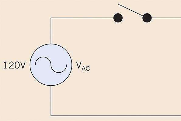

Fig. 1. A simplified model of a 1kW cold cathode lighting transformer fed by a 120V source.

To simplify the situation, I modeled the 1kW cold cathode lighting transformer as a pure resistor (R1) (Fig. 1). Note: 1kW is measured at nominal voltage of 120V.

Fig. 2. To limit the voltage seen by the cold cathode transformer, a small resistor (R2) was inserted in the 120V circuit.
To limit the voltage to 125V across R1 when the supply voltage hit a high of 133V, a new resistor (R2) needed to be inserted in series with R1. The addition of resistor R2 means that an 8V drop would be seen across R2. The remaining voltage (125V) will be seen across resistor R1 (Fig. 2).
We use the following fractional comparison to find the value of R2:
VR2/R2 = VR1/R1
8V/R2 = 125V/14.4
Rearranging the equation to solve for R2 results in R2 = 0.92 Ω.
At this point, I purchased two 0.9 Ω rib-wound resistors for a total of $32. After inserting one of them into the circuit path, the problem was solved at an expense of less than 70W of heat loss due to the resistor. The second backup resistor still sits on my desk to this day, having never been called into service.
