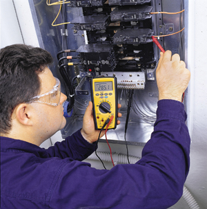

Testing voltage.
To test for voltage, first determine whether the application you're testing uses AC or DC voltage. Then set the dial to the appropriate function: V_ for AC voltage or V for DC voltage.
Like all test procedures, when testing voltage set the range to the number just higher than the expected reading. If you don't know the expected range, set the range to the highest number.
Plug your test leads into the port panel as described in Fig. 1. For AC voltage, take the leads and apply them to the circuit, making sure that no part of your body contacts any part of the live circuit. The position of the test leads may need to be adjusted until a reliable measurement appears on the LCD. Then read the voltage measurement displayed.
When testing AC voltage, you'll encounter fluctuations in the reading. As the test continues the reading will stabilize to yield a reliable measurement.
For DC voltage, connect the black test lead to the negative polarity point (ground) and the red lead to the positive polarity test point. Then take a reading.
