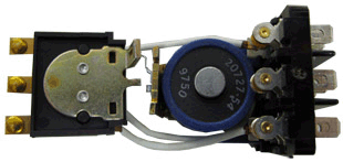

Photo 1. A DC relay showing pole-piece inside of the coil; the contacts were removed to show the coil.

DC relays consist of wire wound on a bobbin, which is placed over a ferromagnetic core. A hinged contact assembly is positioned over the core (Photo 1). When current is applied to the coil, flux is induced in the ferromagnetic core, causing the contacts to close.
