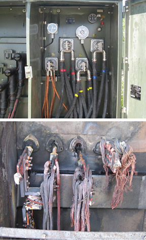

Proper implementation of arc flash hazard analysis can significantly reduce injuries from arc flash and arc blast events
The most significant safety issue in the electrical industry is the threat of electrical workers being injured or killed by arcs and blasts. The principal hazards associated with such arcs and blasts include thermal burn injuries and physical trauma from the blast concussion and flying projectiles caused by partially melted components being propelled by the force of the blast. Therefore, it’s important to understand that the focus of arc flash hazard analysis (AFHA) is to mitigate hazards — not merely to select flame-resistant (FR) clothing.
