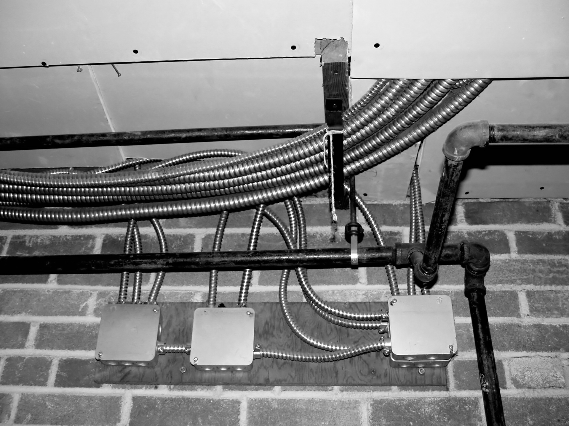

Metal-clad (MC) cable is one of the essential wiring methods commercial electricians use in their daily work. This Chapter 3 wiring method is approved for use in dwelling units and "other than" building types (e.g., commercial, health care, and industrial). This article will give apprentices practical information on industry-recommended practices, installation tips, and NEC guidelines (Art. 330) for the correct application and use of MC cable (Type MC).
The metallic corrugated jacket of MC cable is constructed of interlocked corrosion-resistant steel or aluminum that provides electricians just the right amount of flexibility and abrasion resistance when pulled through wood or metal studs, nailed to joists, or strapped to the surface of walls and ceilings. MC cable is manufactured in various styles, colors, conductor sizes, and configurations. You can find customized cable configurations for specific purposes (e.g., fire protection, audio/video, health care equipment, and harmonic noise reduction).
To help resolve harmonic noise problems, the cable may contain either a single grounded conductor sized 150% to 200% of the circuit conductors (super neutrals) or multiple grounded conductors. MC cable can be used in, but is not limited to, dwelling units and the following Chapter 5 special occupancies (see Photo below).
