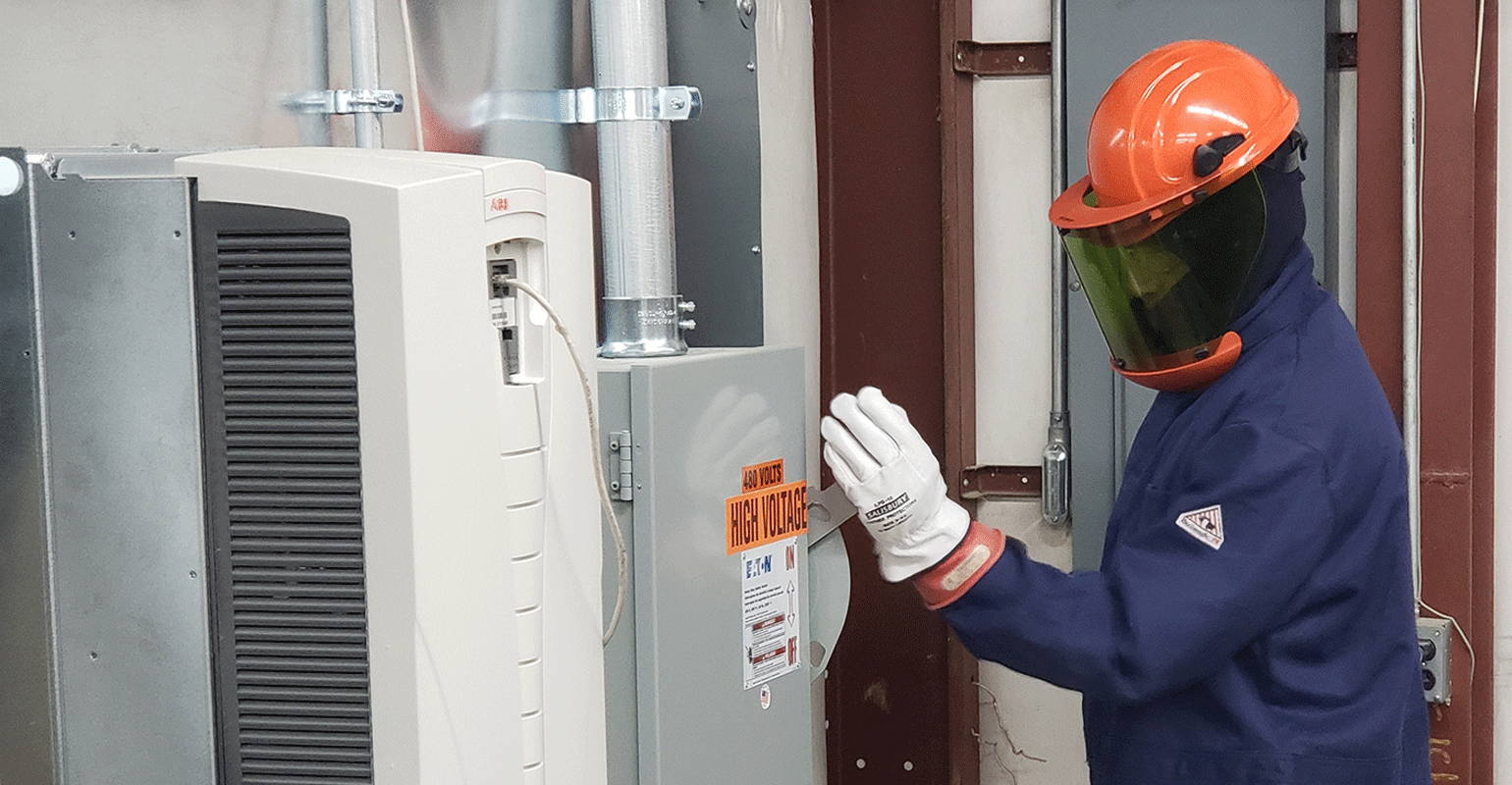

This statement sounds like it lines up perfectly with the requirements of NFPA 70E. However, a serious oversight is implied in this statement, because typically more employees than just electricians need electrical safety training. The requirement states that employees who are exposed to electrical hazards must be trained according to the level of their exposure. There are several categories of employees who are exposed to electrical hazards but do not receive appropriate safety training. These include engineers, instrument technicians, HVAC technicians, facility operators, etc. Employers must evaluate each category of employee to determine if he or she is exposed to arc flash or shock hazards and, if so, provide the appropriate level of training. In some cases, making minor work task changes can shift certain categories of employees away from electrical hazard exposure.

The short answer is no; training alone is not enough. Electrical safety training cannot be viewed as simply placing a check in the box for putting employees through a training course. Electrical safety training is one step in an electrical safety program that needs to be constantly refreshed. The NFPA 70E committee recognized this and established several requirements for an overall electrical safety program that is designed to move the culture in a positive direction when applied appropriately.
One important piece of this culture change is the requirement to perform audits. It is not enough for an employer to provide appropriate training and then assume every employee will follow the requirements presented during the training. The employer is also required to conduct annual audits of electrical work to ensure the appropriate electrical safe work practices are being followed. The audits need to be performed by someone knowledgeable about safe electrical work practices so that they can determine if employees are indeed putting the requirements into practice. The best approach would be to have someone knowledgeable in safe electrical work practices regularly interacting with employees in the field to encourage the application of the safety principles taught during the training.
