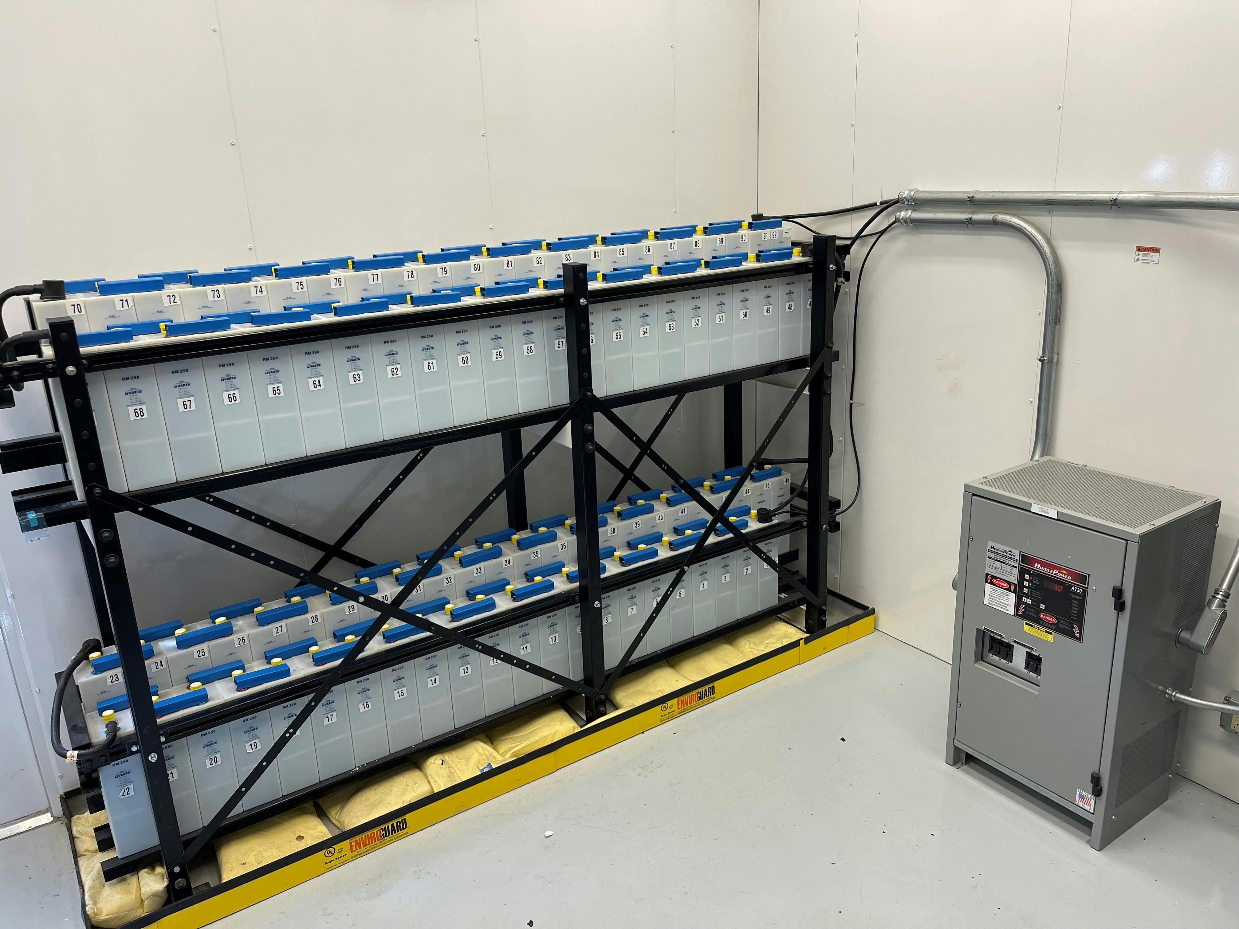

The best solution is to place battery systems where they are visible during a standard system walk-through. In utility substations, these battery strings are typically located on the floor of the substation control room and are completely visible so that even minor issues can be observed (Photo 3).

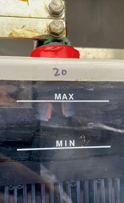

  • Other cracked or damaged internals such as a cracked internal seal (Photo 5).
  • Acid levels not between the high and low marks (Photo 5).

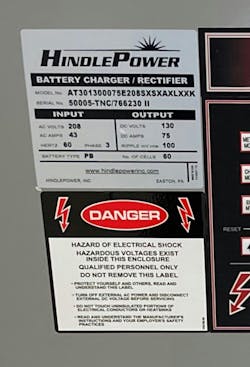

  4. Measure the charger output for AC ripple. Excessive AC ripple can shorten battery life by creating a situation where the battery is repeatedly undercharged and discharged.
    1. One battery manufacturer recommends that a maximum ripple of 1.5% of the voltage be allowed during the bulk phase of the charging and a maximum of 0.5% voltage ripple during the float phase.
    2. Remember to check battery charger manufacture literature for ripple levels. The nameplate in Photo 6 lists the design ripple as 100mV rms.
