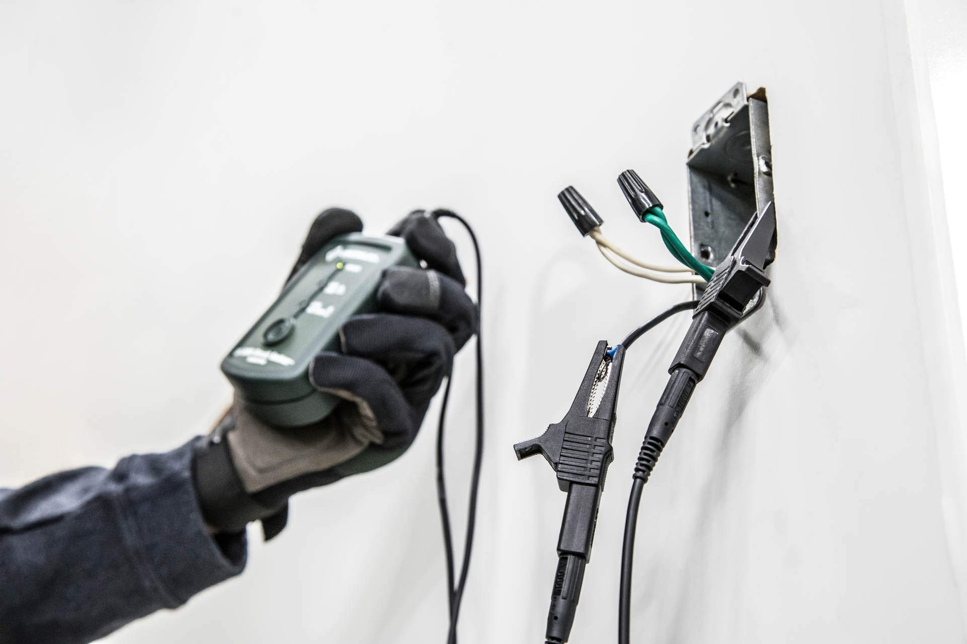

If an outlet is not available, use alligator clips on your test leads to connect to the conductors.

This setup is dependent on what you’re looking for. If you are tracing conduit, data cable, or coaxial cables, use alligator clips to make a connection, while making sure you have a good ground. If possible, ground the far end of the conductor for better results. For most live breakers or tracing of GFCI-protected circuits, you will simply plug the transmitter into the outlet in question. You can still use proper leads if an outlet is not available (Figure).
