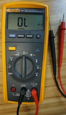

Photo courtesy of Fluke
Photo 1. The digital multimeter (DMM) is the most commonly used type of multimeter. This DMM has a removable display for safety and can be used for various measurements, including AC and DC voltage and current, resistance, frequency, and temperature when the thermocouple accessory is used.

Two basic types of multimeters are in use today — the analog multimeter and the digital multimeter (DMM), as shown in Photo 1. Although the digital version is by far the most used type, the competent electrical professional needs to be comfortable with analog meters, too.

For the user in the field, the single biggest advantage of the DMM is ease of use. These devices are easily carried, rugged, reliable, and simple to use. However, the user must understand each multimeter function to be most effective.
All multimeters measure voltage, current, and resistance. Some offer more specific functions and features, such as the ability to measure frequency, capacitance, and even temperature. Additionally, modern DMMs are auto-ranging. Rather than selecting the appropriate range on a selector switch for the values to be observed, the meter automatically detects the voltage, current, or resistance value and selects a range for the measurement. DMMs may also have the option to manually select the desired range. However, those operating the DMM must be comfortable selecting the correct meter function and understand the various indications on the meter face.
TIP #2: Familiarize yourself with your multimeter functions, capabilities, and ratings before usage. In the field, effective multimeter use should be second nature to the electrical worker (see manual diagram below).

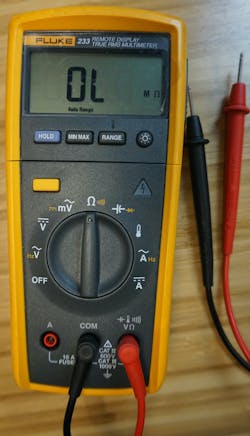

Measuring resistance and “ringing out a circuit”
Measuring resistance values can easily be done with a DMM. The unit’s battery pushes current flow through one meter lead and into the circuit. The current then flows from the circuit into the opposite test lead and back into the meter battery. The meter is designed to analyze the amount of current that flows through the circuit and display the resistance reading in ohms, kilohms, or megaohms, as applicable.
TIP #8: Always verify a circuit is de-energized before measuring resistance. DMMs have protective circuitry, and some may indicate the circuit is energized if attempting to read resistance. However, attempting to apply low-voltage DC batteries found in multimeters to an energized 120VAC circuit or above is never a good idea.
While actual resistance values are sometimes needed, troubleshooting is often accomplished by testing for continuity. The term “ringing out the circuit” most likely evolved when some of the first continuity testers used a battery and doorbell in series with the circuit under test. If there was a complete path of current flow from the battery, through the circuit and doorbell, and back to the battery, then the bell would ring, indicating continuity. Today’s DMM provides both visual and audible indications.
